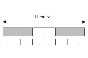

In the diagram on the right you can see that the variable i takes up two storage locations. In the PICmicro microcontroller there are just two sizes of variable, 8 bit values (char) which are held in a single location, and 16 bit values (int) which are held in two locations. Note that these sizes are not common to all C versions of C.
i is a 16-bit value, and therefore takes up two memory locations
